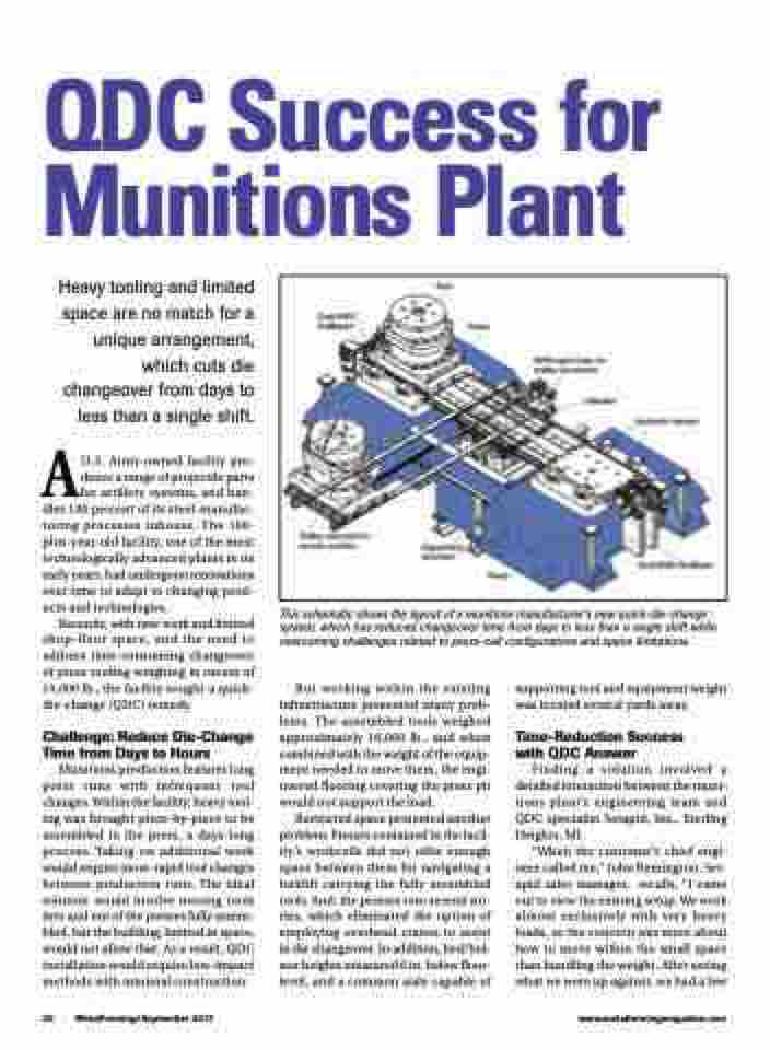

Recently, with new work and limited shop-floor space, and the need to address time-consuming changeover of press tooling weighing in excess of 15,000 lb., the facility sought a quick- die-change (QDC) remedy.
Challenge: Reduce Die-Change Time from Days to Hours
Munitions production features long press runs with infrequent tool changes. Within the facility, heavy tool- ing was brought piece-by-piece to be assembled in the press, a days-long process. Taking on additional work would require more-rapid tool changes between production runs. The ideal solution would involve moving tools into and out of the presses fully assem- bled, but the building, limited in space, would not allow that. As a result, QDC installation would require low-impact methods with minimal construction.
This schematic shows the layout of a munitions manufacturer’s new quick-die-change system, which has reduced changeover time from days to less than a single shift while overcoming challenges related to press-cell configurations and space limitations.
20 MetalForming/September 2017
But working within the existing infrastructure presented many prob- lems. The assembled tools weighed approximately 16,000 lb., and when combined with the weight of the equip- ment needed to move them, the engi- neered flooring covering the press pit would not support the load.
Restricted space presented another problem: Presses contained in the facil- ity’s workcells did not offer enough space between them for navigating a forklift carrying the fully assembled tools. And, the presses rose several sto- ries, which eliminated the option of employing overhead cranes to assist in die changeover. In addition, bed/bol- ster heights measured 6 in. below floor- level, and a common aisle capable of
supporting tool and equipment weight was located several yards away.
