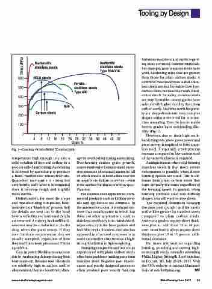

  Fig. 1—Courtesy ArcelorMittal (Constructalia)

fuel misconceptions and myths regard- ing these corrosion-resistant materials. For example, most stainless steels have work-hardening rates that are greater than those for plain carbon steels. A common misconception is that stain- less steels are less formable than low- carbon steels because they work-hard- en too much. In reality, stainless steels are very formable—many grades have substantially higher ductility than plain carbon steels. Stainless steels frequent- ly are deep-drawn into very complex shapes without the need for interme- diate annealing. Even the less formable ferritic grades have outstanding duc- tility (Fig. 1).
However, due to their high work- hardening rate, more press power and press energy is required to form stain- less steel. Frequently, a 100-percent increase compared to low-carbon steel of the same thickness is required.
A unique feature when cold-forming stainless steels is that more severe deformation is possible when slower forming speeds are used. This is dif- ferent from plain carbon steels that form virtually the same regardless of the forming speed. In general, when forming stainless steel into difficult shapes, you will want to slow down.
The required clearances between the draw post (punch) and die-cavity wall will be greater for stainless steels compared to plain carbon steels. Austenitic grades require sheet thick- ness plus an additional 35 to 40 per- cent; most ferritic alloys require sheet thickness plus 10 to 15 percent addi- tional clearance.

  600
500
400
300
200
100
Ferritic stainless steels Type 430
      Carbon steels
A36
                 4
8 12 16 20 24 28 32 36 40 44 48 52 Strain %
Stress (MPa)
