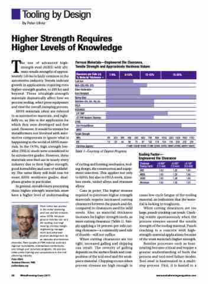

Ferrous Materials—Engineered Die Clearance, Tensile Strength and Approximate Hardness Values
     Clearance per Side (Δ) % Material Thickness→
 Cast Iron
Mild–CRS,HRS, CDS Bake-Hardenable– Dent-Resistant
Spring Steel
Stainless–2xx, 3xx, 4xx, etc. HSLA
HSS/AHSS
DP, TWIP
CP, TRIP, Austenic Stainless UHSS
Hot-Formed/Boron
MART
Tensile Strength
MPa
KSI
Hardness (approx.)
69 200 300 400 500 600 700 800 1000 1200 1400 1600 1750 10 29 44 58 73 87 102 116 145 174 203 232 255
114HB 144HB 183HB 213HB 22HRC 33HRC 38HRC 43HRC 48HRC 50HRC
                Table 1—Courtesy of Dayton Progress

Case in point: The higher stresses required to penetrate higher-strength materials require increased cutting clearances between the punch and die, compared to clearances used for mild steels. Also, as material thickness increases for higher-strength steels, so must cutting clearance ( Table 1). Sim- ply applying a 10-percent-per-side cut- ting clearance—a commonly used rule of thumb—will not suffice.
When cutting clearances are too tight, increased galling and chipping can result. The severity of galling depends on the surface finish and com- position of the tool steel and the work- piece material. Chipping occurs when process stresses are high enough to
Scaling Factor— Engineered Die Clearance
HSS 1.00 1.20 1.40 AHSS 1.00 1.20 1.40 UHSS 1.00 1.30 1.40 Aluminum 1.00 1.03 1.05
cause low-cycle fatigue of the tooling material, an indication that the mate- rial is lacking in toughness.
When cutting clearances are too large, punch cracking can result. Crack- ing results spontaneously when the process stresses exceed the tensile strength of the tooling material. Punch cracking is a concern with high- strength-material applications because of the work material’s higher strength.

7-9%
9-12%
12-15%
      38 MetalForming/June 2017
15-20%
           Thickness <0.060" >0.060" >0.120"
Scaling Factor (1.5 mm) (1.5 mm) (3.0 mm)
