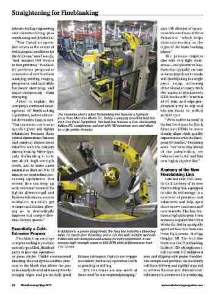

“Our Canadian opera- tion serves as the center of technological excellence for the Americas,” says Taraschi, “and mentors Util Mexico in best practices.” The facil- ity performs progressive conventional and fineblank stamping, welding, swaging, progressive and multislide hardware stamping, and noise-dampening shim stamping.
Asked to explain the company’s continued devel- opment of fineblanking capabilities, technical direc- tor Alessandro Luppis says: “Our customers continue to specify tighter and tighter tolerances, because these critical dimensions (flatness and external dimensions) interfere with the calipers during braking. We’re typi- cally fineblanking 5- to 8- mm-thick high-strength steels, and in some cases material as thick as 10 to 12 mm, so we need robust pro- cessing equipment. Our newest line can keep up with customer demand for tighter dimensional and flatness tolerances, even as workpiece materials get stronger and thicker, allow- ing us to dramatically improve our competitive- ness on new quotes.”

The Canadian plant’s latest fineblanking line features a hydraulic press from Mori Iron Works Co., fed by a uniquely specified feed line from Coe Press Equipment. The feed line features a Coe Fineblanking Edition HD straightener, coil reel with HD holddown arm, and alliga- tor-style peeler-threader.

Late last year, Util Cana- da took delivery of its new fineblanking line, equipped to take its technology to a new level of precision and robustness and help open doors to new customers and new markets. The line fea- tures a hydraulic press from Japanese supplier Mori Iron Works Co., fed by a uniquely specified feed line from Coe Press Equipment, Sterling Heights, MI. The feed line features a Coe Fineblanking Edition HD straightener, coil reel with HD holddown

arm, and alligator-style peeler-threader. The straightener provides the necessary roll-force delivery and rigidity required to achieve flatness and dimensional- tolerance requirements for producing

In addition to a power straightener, the feed line includes a threading table, for hands-free threading; and a coil reel with multiple hydraulic holddowns and motorized end wheels for coil containment. It can process high-strength steels to 620-MPa yield at thicknesses from 3to12mm.
