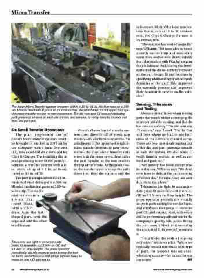

Micro Transfer
  The Jacar Micro Transfer system operates within a 30 by 45-in. die that runs on a 300- ton Minster mechanical press at 25 strokes/min. An attachment in the upper tool syn- chronizes transfer motion to ram movement. The die contains 12 sensors including part-presence sensors at each die station, and sensors to verify transfer motion, coil feed and part-out.

Six Small Transfer Operations
The plan: implement one of Gunst’s Micro Transfer systems, which he brought to market in 2007 under the company name Jacar Systems LLC, into a coil-fed die developed for Clips & Clamps. The resulting die, at peak producing some 30,000 parts/yr., features a transfer system with a 6- in. pitch, along with 2 in. of in-out travel and 1 in. of lift.
The part is stamped from 0.040-in.- thick mild steel delivered to a 300-ton Minster mechanical press as 3.85-in.- wide strip. The six die
stations create a
3.5-in.-dia.
round blank,
form a 1.5-in.
draw, trim the hat-
shaped part, coin the
edge and add the offset
bead feature.
Gunst’s all-mechanical transfer sys- tem runs directly off of press-ram motion—no electronics or servos. An attachment in the upper tool synchro- nizes transfer motion to ram move- ment—the downsized transfer rails move in as the press opens, then index the part forward as the ram reaches the top of the stroke. As the press clos- es, the transfer systems brings the parts down into their die stations and the
 Tolerances are tight to accommodate
press-fit assembly—±0.2 mm on OD and
0.5 mm on draw height. The press operator periodically visually inspects parts exiting the tool for burrs, and employs a test gauge (shown here) to measure part OD and runout.
