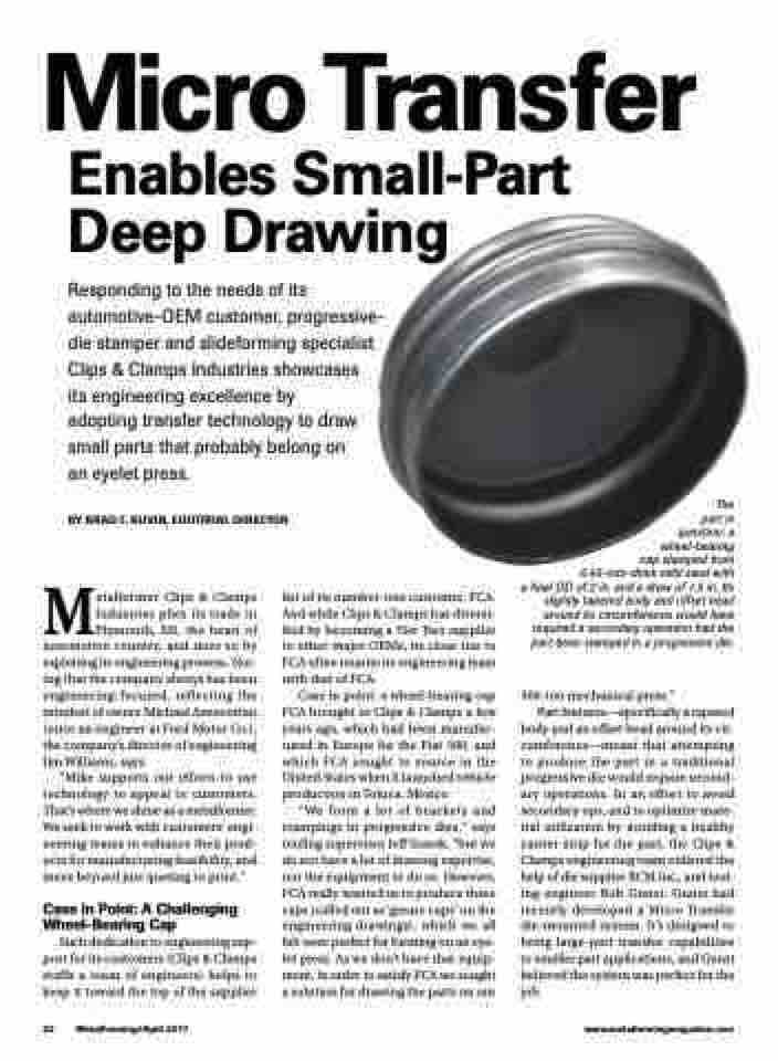

The part in question: a wheel-bearing cap stamped from 0.40-mm-thick mild steel with a final OD of 2 in. and a draw of 1.5 in. Its slightly tapered body and offset bead around its circumference would have required a secondary operation had the part been stamped in a progressive die.
