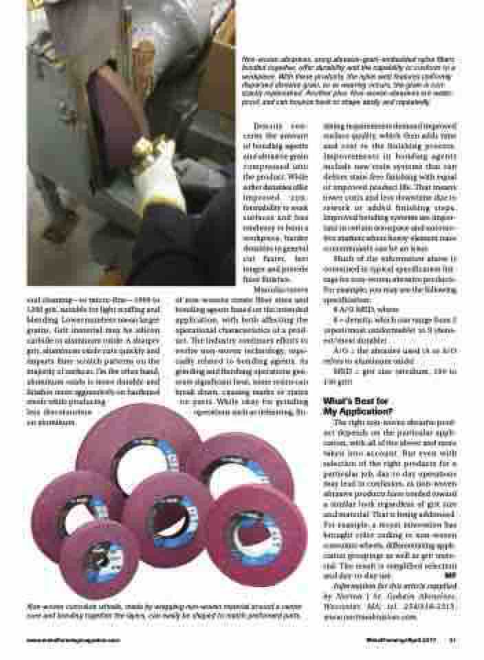

Non-woven abrasives, using abrasive-grain-embedded nylon fibers bonded together, offer durability and the capability to conform to a workpiece. With these products, the nylon web features uniformly dispersed abrasive grain, so as wearing occurs, the grain is con- stantly replenished. Another plus: Non-woven abrasives are water- proof, and can bounce back to shape easily and repeatedly.
 Non-woven convolute wheels, made by wrapping non-woven material around a center core and bonding together the layers, can easily be shaped to match preformed parts.
