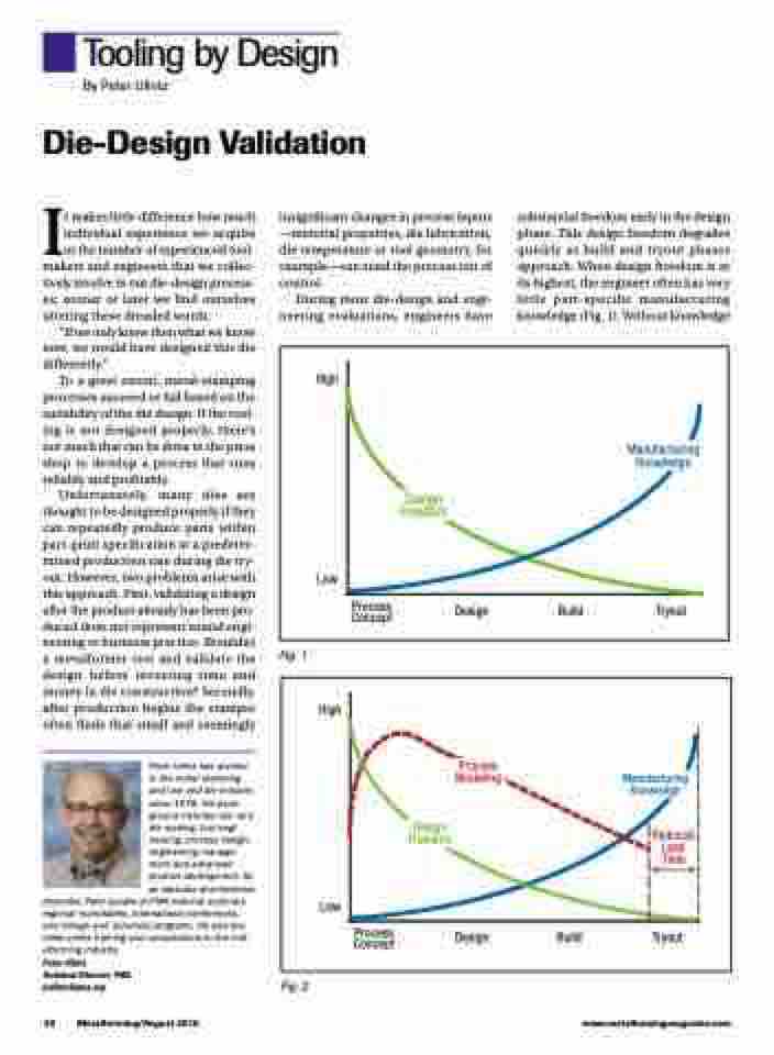

To a great extent, metal-stamping processes succeed or fail based on the suitability of the die design. If the tool- ing is not designed properly, there’s not much that can be done in the press shop to develop a process that runs reliably and profitably.
Unfortunately, many dies are thought to be designed properly if they can repeatedly produce parts within part-print specification at a predeter- mined production rate during die try- out. However, two problems arise with this approach. First, validating a design after the product already has been pro- duced does not represent sound engi- neering or business practice. Shouldn’t a metalformer test and validate the design before investing time and money in die construction? Secondly, after production begins the stamper often finds that small and seemingly

During most die-design and engi- neering evaluations, engineers have
substantial freedom early in the design phase. This design freedom degrades quickly as build and tryout phases approach. When design freedom is at its highest, the engineer often has very little part-specific manufacturing knowledge (Fig. 1). Without knowledge
  High
     Manufacturing Knowledge
  Design Freedom
 Low
Process Concept
Design Build Tryout
Fig. 1
    High
                Process Modeling
Design Freedom
Reduced Lead Time
Tryout
                          Low
       Process Concept
Design
Build
  38 MetalForming/August 2016
Fig. 2
