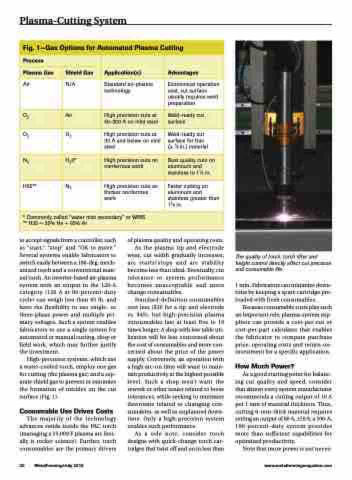

Plasma-Cutting System
     Fig. 1—Gas Options for Automated Plasma Cutting
  Process
  Application(s)
 Advantages
 Plasma Gas
 Shield Gas
Air
N/A
Standard air-plasma technology
Economical operation cost, cut surface usually requires weld preparation
 O2
 Air
 High precision cuts at 50-300 A on mild steel
 Weld-ready cut surface
O2
O2
High precision cuts at 30 A and below on mild steel
Weld-ready cut surface for thin (≤ 1⁄8 in.) material
 N2
 H20*
 High precision cuts on nonferrous work
 Best quality cuts on aluminum and stainless to 11⁄4 in.
H35**
N2
High precision cuts on thicker nonferrous work
Faster cutting on aluminum and stainless greater than 11⁄4 in.
  * Commonly called “water mist secondary” or WMS ** H35 = 35% He + 65% Ar

High-precision systems, which use a water-cooled torch, employ one gas for cutting (the plasma gas) and a sep- arate shield gas to prevent or minimize the formation of nitrides on the cut surface (Fig. 1).

The quality of torch, torch lifter and height control directly affect cut precision and consumable life.
