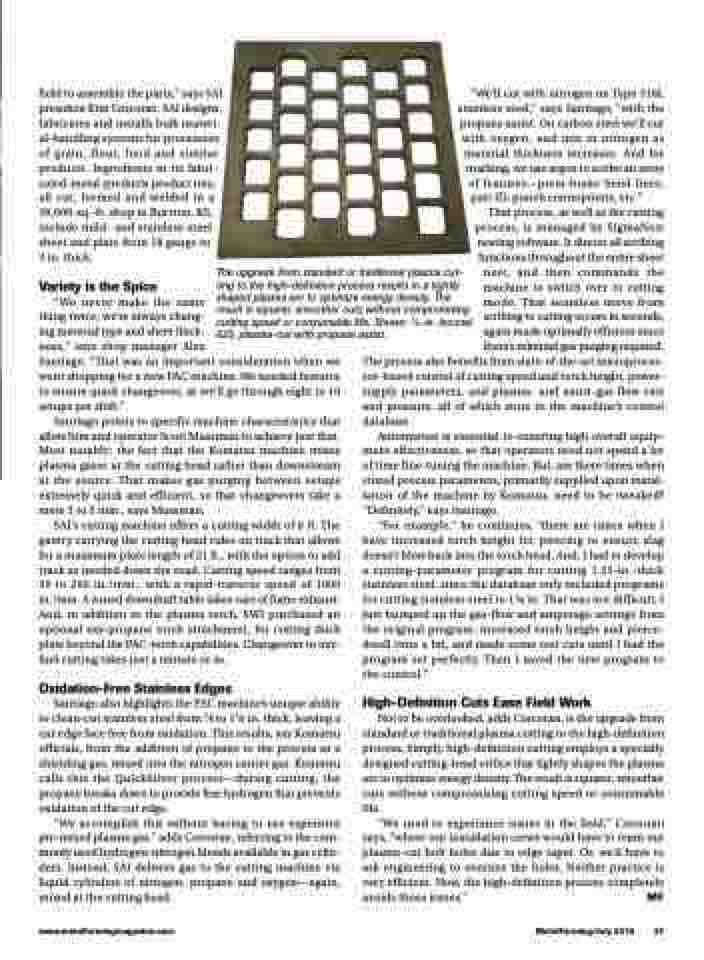

The upgrade from standard or traditional plasma cut- ting to the high-definition process results in a tightly shaped plasma arc to optimize energy density. The result is squarer, smoother cuts without compromising cutting speed or consumable life. Shown: 1⁄4-in. Inconel 625, plasma-cut with propane assist.

Not to be overlooked, adds Corcoran, is the upgrade from standard or traditional plasma cutting to the high-definition process. Simply, high-definition cutting employs a specially designed cutting-head orifice that tightly shapes the plasma arc to optimize energy density. The result is squarer, smoother cuts without compromising cutting speed or consumable life.
“We used to experience issues in the field,” Corcoran says, “where our installation crews would have to ream out plasma-cut bolt holes due to edge taper. Or, we’d have to ask engineering to oversize the holes. Neither practice is very efficient. Now, the high-definition process completely
avoids those issues.”
