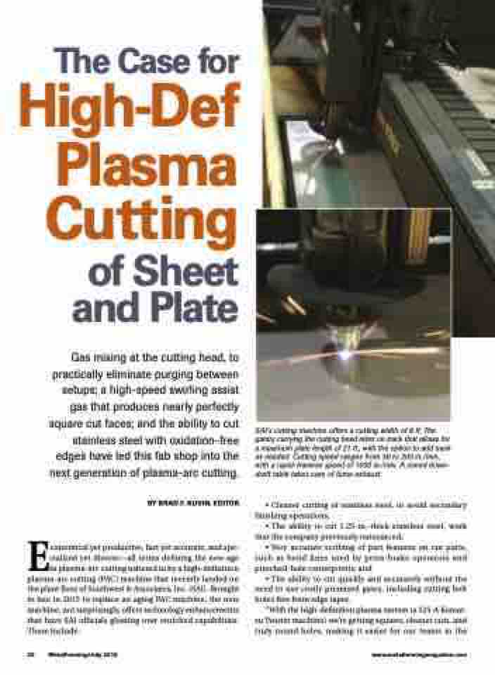

SAI’s cutting machine offers a cutting width of 8 ft. The gantry carrying the cutting head rides on track that allows for a maximum plate length of 21 ft., with the option to add track as needed. Cutting speed ranges from 30 to 200 in./min., with a rapid-traverse speed of 1000 in./min. A zoned down- draft table takes care of fume exhaust.
