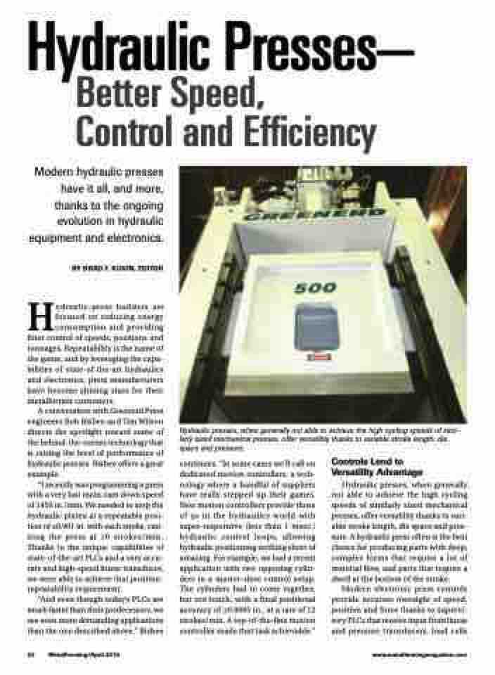

Hydraulic presses, when generally not able to achieve the high cycling speeds of simi- larly sized mechanical presses, offer versatility thanks to variable stroke length, die space and pressure.
