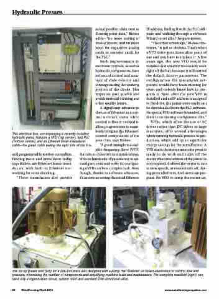

  This electrical box, accompanying a recently installed hydraulic press, features a VFD (top center), fast PLC (bottom center), and an Ethernet linear-transducer cable—the green cable exiting the right side of the box.

  The 20-hp power unit (left) for a 300-ton press was designed with a pump that featured on-board electronics to control flow and pressure, minimizing the number of components and simplifying machine build and maintenance. The complete manifold (right) con- tains only a regenerative circuit, system relief and standard D08 directional valve.
