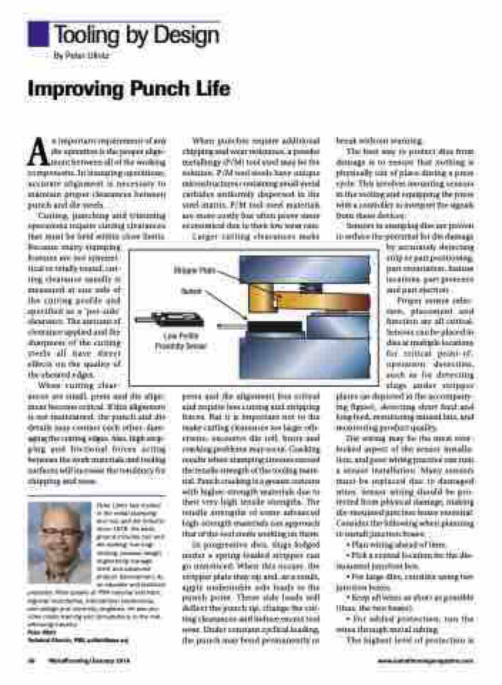

The best way to protect dies from
damage is to ensure that nothing is physically out of place during a press cycle. This involves mounting sensors in the tooling and equipping the press with a controller to interpret the signals from these devices.
Sensors in stamping dies are proven to reduce the potential for die damage by accurately detecting strip or part positioning, part orientation, feature locations, part presence
and part ejection. Proper sensor selec-
tion, placement and function are all critical. Sensors can be placed in dies at multiple locations for critical point-of- operation detection, such as for detecting slugs under stripper
plates (as depicted in the accompany- ing figure), detecting short feed and long feed, monitoring missed hits, and monitoring product quality.
Die wiring may be the most over- looked aspect of the sensor installa- tion, and poor wiring practice can ruin a sensor installation. Many sensors must be replaced due to damaged wires. Sensor wiring should be pro- tected from physical damage, making die-mounted junction boxes essential. Consider the following when planning to install junction boxes:
• Plan wiring ahead of time.
• Pick a central location for the die- mounted junction box.
• For large dies, consider using two junction boxes.
• Keep all wires as short as possible (thus, the two boxes).
• For added protection, run the wires through metal tubing.

   Stripper Plate Sensor
Low Profile Proximity Sensor

In progressive dies, slugs lodged under a spring-loaded stripper can go unnoticed. When this occurs, the stripper plate may tip and, as a result, apply undesirable side loads to the punch point. These side loads will deflect the punch tip, change the cut- ting clearances and induce excess tool wear. Under constant cyclical loading, the punch may bend permanently or
