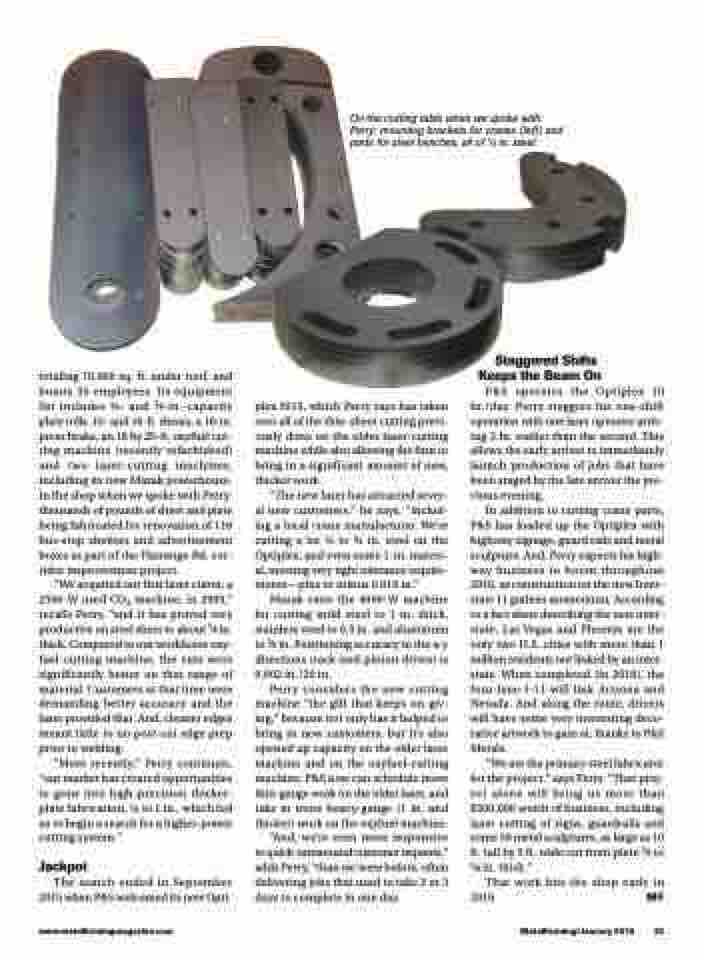

 On the cutting table when we spoke with Perry: mounting brackets for cranes (left) and parts for steel benches, all of 1⁄2 in. steel.
