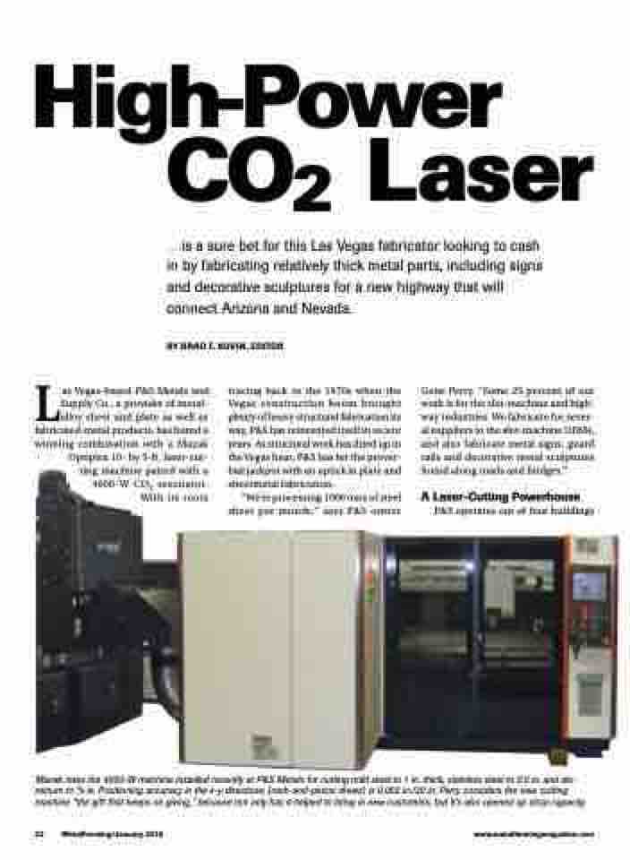

 Mazak rates the 4000-W machine installed recently at P&S Metals for cutting mild steel to
minum to 3⁄8 in. Positioning accuracy in the x-y directions (rack-and-pinion drives) is 0.002
machine “the gift that keeps on giving,” because not only has it helped to bring in new customers, but it’s also opened up shop capacity.

1 in. thick, stainless steel to 0.5 in. and alu- in./20 in. Perry considers the new cutting
