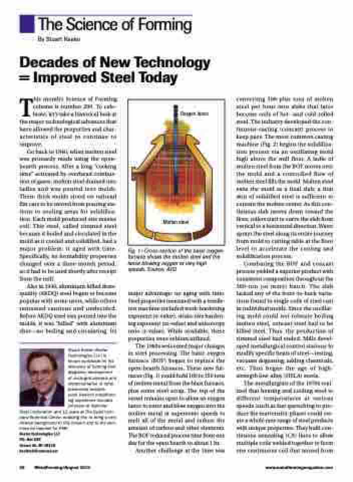

Fig. 1—Cross-section of the basic oxygen furnace shows the molten steel and the lance blowing oxygen at very high speeds. Source: AISI
major advantage: no aging with time. Steel properties measured with a tensile- test machine included work-hardening exponent (n-value), strain-rate harden- ing exponent (m-value) and anisotropy ratio (r-value). While available, these properties were seldom utilized.
The 1960s welcomed major changes in steel processing. The basic oxygen furnace (BOF) began to replace the open-hearth furnaces. These new fur- naces (Fig. 1) could hold 100 to 350 tons of molten metal from the blast furnace, plus some steel scrap. The top of the vessel remains open to allow an oxygen lance to enter and blow oxygen into the molten metal at supersonic speeds to melt all of the metal and reduce the amount of carbon and other elements. The BOF reduced process time from one day for the open hearth to about 1 hr.
