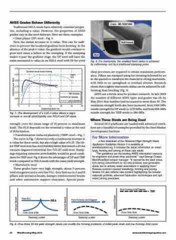

P. 30
   2 mm – MS 1050/1400
Roll Formed
   Bent
AHSS Grades Behave Differently
Traditional HSLA steels have relatively constant proper- ties, including n-value. However, the properties of AHSS grades vary as the steel deforms. Here are three examples.
• Dual-phase (DP) steel—Fig. 6
Note the initial increase in n-value. This can be suffi- cient to prevent the localized gradient from forming. In the absence of the peak n-value, the gradient would continue to grow and cause a failure in the stamping. If the stamping makes it past the gradient stage, the DP steel will have the same measured n-value as an HSLA steel with 50-ksi yield
Fig. 9—For martensite, the smallest bend radius is achieved by rollforming—not by a traditional stamping press.
shop processes are required to obtain maximum perform- ance. Pillars are stamped using hot forming followed by an in-die quench to transform the material to strong martensite, with little to no springback or residual stresses. Research shows that a tighter martensite radius can be achieved by roll- forming than bending (Fig. 9).
AHSS are a fertile area for product research. In late 2009 the number of different AHSS types and grades was 28; by May 2014 that number had increased to more than 50. The maximum strength levels also have increased, from 1000-MPa tensile strength for DP steels to 1270 MPa, and from 800-MPa tensile strength for TRIP steels to 980 MPa.
Where These Steels are Being Used
Several 2015 platforms are loaded with advanced steels; here are a handful of examples provided by the Steel Market Development Institute.
  0.30 0.25 0.20 0.15 0.10 0.05
0 5 10 15 20 25 30 Engineering Strain (%)
       Excellent overall stretch forming
 Higher FLD
         TRI
P 350/600
DP 350/600 HSLA 350/450
                            Fig. 7—The development of a 0.25 n-value allows a major increase in overall stretchability over HSLA and DP steels.
strength (over the strain range of 10 percent to maximum load). The FLD depends on the terminal n-value at the end of deformation.
• Transformation-induced plasticity (TRIP) steel—Fig. 7
The curve in Fig. 7 shows not only a continuous increase in n-value for these steels, but also a high value of 0.25. The 50- ksi TRIP steel now has stretchability limits that match a 20-ksi vacuum-degassed interstitial-free (VD-IF) mild steel. Stamp- ings requiring extensive stretchability would be good candi- dates for TRIP steel. Fig. 8 shows the advantages of DP and TRIP steels compared to HSLA steels with the same yield strength.
• Martensitic steel
These grades have very high strength, about 5-percent total elongation and a very low FLC; they find use in A and B pillars, side intrusion beams, bumper-reinforcement beams and other automotive support structures. Special press-

    From Forming Limit Diagram
From Circle Grids
TRIP
 From FLC
From Circle Grids Stamping Location
HSLA
From Circle Grids
Stamping Location
DP
   Stamping Location
Fig. 8—How three 50-ksi yield-strength steels can modify the forming problems of initial peak strain and low forming-limit curve.
28 MetalForming/May 2015 www.metalformingmagazine.com
Percent Stretch
Percent Stretch
Percent Stretch
Instantaneous n-Value
