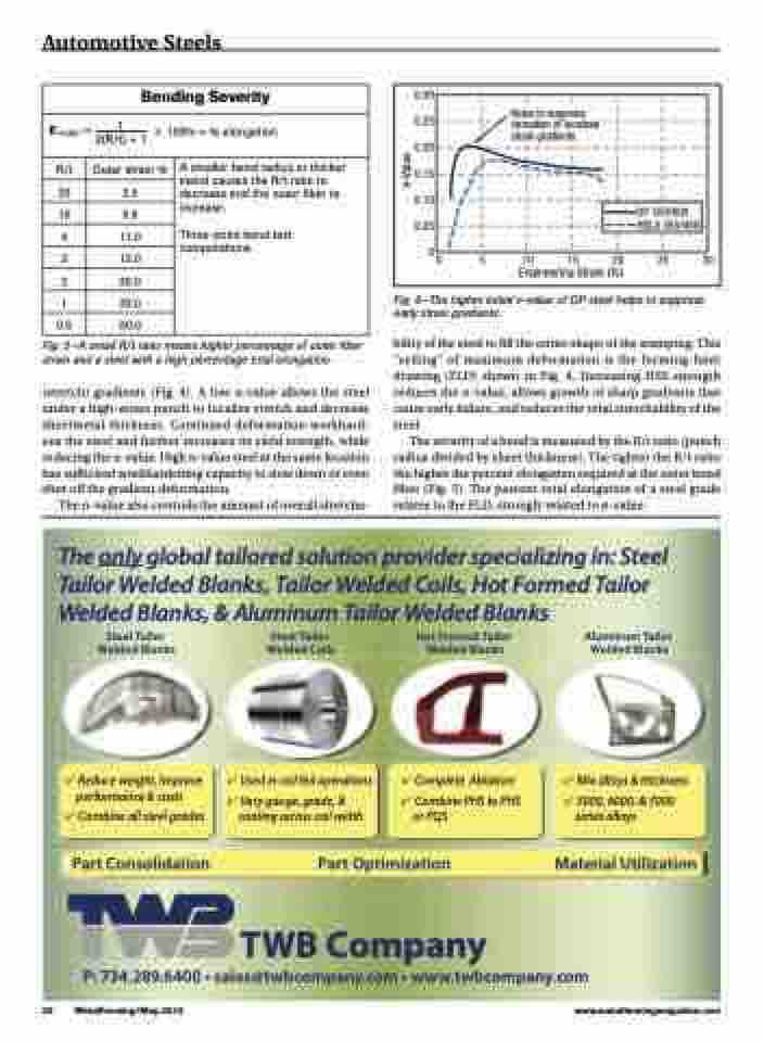

 Automotive Steels
     Bending Severity
 􏰀outer = 1 􏰁 100% = % elongation 2(R/t) + 1
  R/t
Outer strain %
  A smaller bend radius or thicker metal causes the R/t ratio to decrease and the outer fiber to increase.
Three-point bend test computations.
20
2.5
10
5.0
4
11.0
3
15.0
2
20.0
1
33.0
0.5
50.0
  0.30 0.25 0.20 0.15 0.10 0.05
0 5 10 15 20 25 30 Engineering Strain (%)
 Helps to suppress formation of localized strain gradients
  DP 350/600 HSLA 350/450
                  Fig. 5—A small R/t ratio means higher percentage of outer fiber strain and a steel with a high percentage total elongation.
(stretch) gradients (Fig. 4). A low n-value allows the steel under a high-stress punch to localize stretch and decrease sheetmetal thickness. Continued deformation workhard- ens the steel and further increases its yield strength, while reducing the n-value. High n-value steel at the same location has sufficient workhardening capacity to slow down or even shut off the gradient deformation.
The n-value also controls the amount of overall stretcha-
Fig. 6—The higher initial n-value of DP steel helps to suppress early strain gradients.
bility of the steel to fill the entire shape of the stamping. This “ceiling” of maximum deformation is the forming-limit drawing (FLD) shown in Fig. 4. Increasing HSS strength reduces the n-value, allows growth of sharp gradients that cause early failure, and reduces the total stretchability of the steel.
The severity of a bend is measured by the R/t ratio (punch radius divided by sheet thickness). The tighter the R/t ratio the higher the percent elongation required at the outer bend fiber (Fig. 5). The percent total elongation of a steel grade relates to the FLD, strongly related to n-value.
