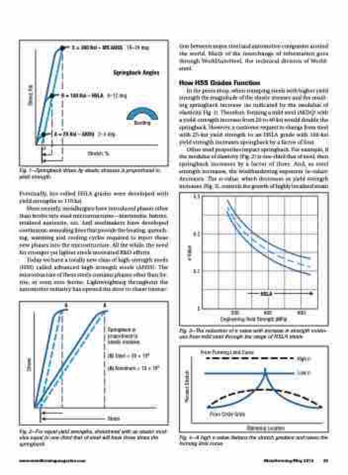

  C = 200 Ksi – MS AHSS 16–24 deg.
Springback Angles
B = 100 Ksi – HSLA 8–12 deg.
            A = 25 Ksi – AKDQ
2–3 deg. Stretch, %
          Fig. 1—Springback driven by elastic stresses is proportional to yield strength.

In the press shop, when stamping steels with higher yield strength the magnitude of the elastic stresses and the result- ing springback increase (as indicated by the modulus of elasticity, Fig. 1). Therefore, forming a mild steel (AKDQ) with a yield-strength increase from 20 to 40 ksi would double the springback. However, a customer request to change from steel with 25-ksi yield strength to an HSLA grade with 100-ksi yield strength increases springback by a factor of four.
Other steel properties impact springback. For example, if the modulus of elasticity (Fig. 2) is one-third that of steel, then springback increases by a factor of three. And, as steel strength increases, the workhardening exponent (n-value) decreases. The n-value, which decreases as yield strength increases (Fig. 3), controls the growth of highly localized strain

     Springback is proportional to elastic modules.

 Fig. 2—For equal yield strengths, sheetmetal with an elastic mod- ulus equal to one-third that of steel will have three times the springback.
Fig. 4—A high n-value flattens the stretch gradient and raises the forming limit curve.

Fig. 3—The reduction of n-value with increase in strength contin- ues from mild steel through the range of HSLA steels.
