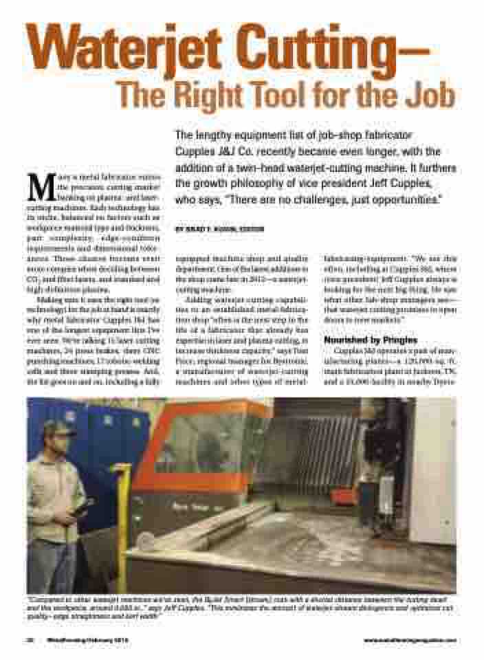

 “Compared to other waterjet machines we’ve seen, the ByJet Smart (shown) cuts with a shorter distance between the cutting head and the workpiece, around 0.060 in.,” says Jeff Cupples. “This minimizes the amount of waterjet-stream divergence and optimizes cut quality—edge straightness and kerf width.”
