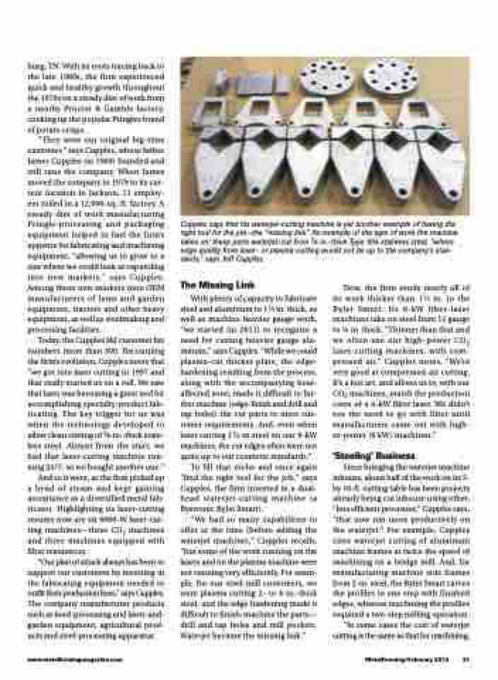

Cupples says that his waterjet-cutting machine is yet another example of having the right tool for the job—the “missing link.” An example of the type of work the machine takes on: these parts waterjet-cut from 5⁄8-in.-thick Type 304 stainless steel, “where edge quality from laser- or plasma-cutting would not be up to the company’s stan- dards,” says Jeff Cupples.
