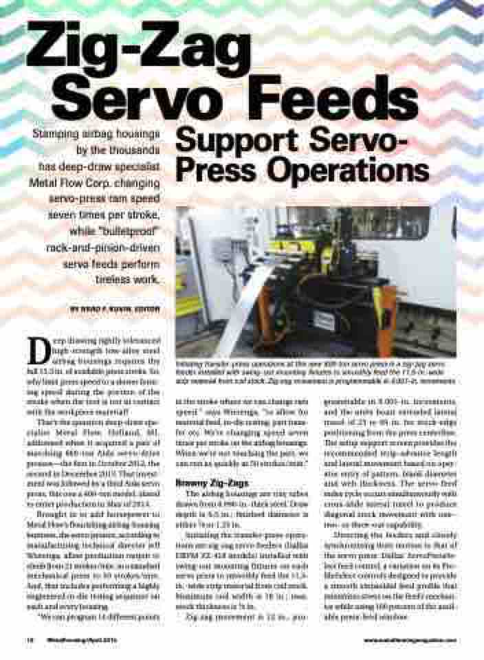

Initiating transfer-press operations at this new 600-ton servo press is a zig-zag servo feeder installed with swing-out mounting fixtures to smoothly feed the 11.5-in.-wide strip material from coil stock. Zig-zag movement is programmable in 0.001-in. increments.

Initiating the transfer-press opera- tions are zig-zag servo feeders (Dallas DRFM ZZ-418 models) installed with swing-out mounting fixtures on each servo press to smoothly feed the 11.5- in.-wide strip material from coil stock. Maximum coil width is 18 in.; max. stock thickness is 1⁄8 in.
Zig-zag movement is 12 in., pro-
grammable in 0.001-in. increments, and the units boast extended lateral travel of 23 to 69 in. for stock-edge positioning from the press centerline. The setup support screen provides the recommended strip-advance length and lateral movement based on oper- ator entry of pattern, blank diameter and web thickness. The servo-feed index cycle occurs simultaneously with cross-slide lateral travel to produce diagonal stock movement with one-, two- or three-out capability.
Directing the feeders and closely synchronizing their motion to that of the servo press: Dallas’ ServoPressSe- lect feed control, a variation on its Pro- fileSelect controls designed to provide a smooth sinusoidal feed profile that minimizes stress on the feed’s mechan- ics while using 100 percent of the avail- able press-feed window.
