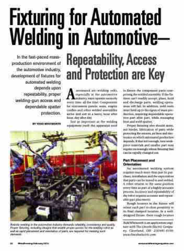

  Robotic welding in the automotive industry demands reliability, consistency and quality. Proper fixturing, including designs that enable proper access for the welding robot as well as rapid placement and orientation of parts, are required for meeting such demands.
