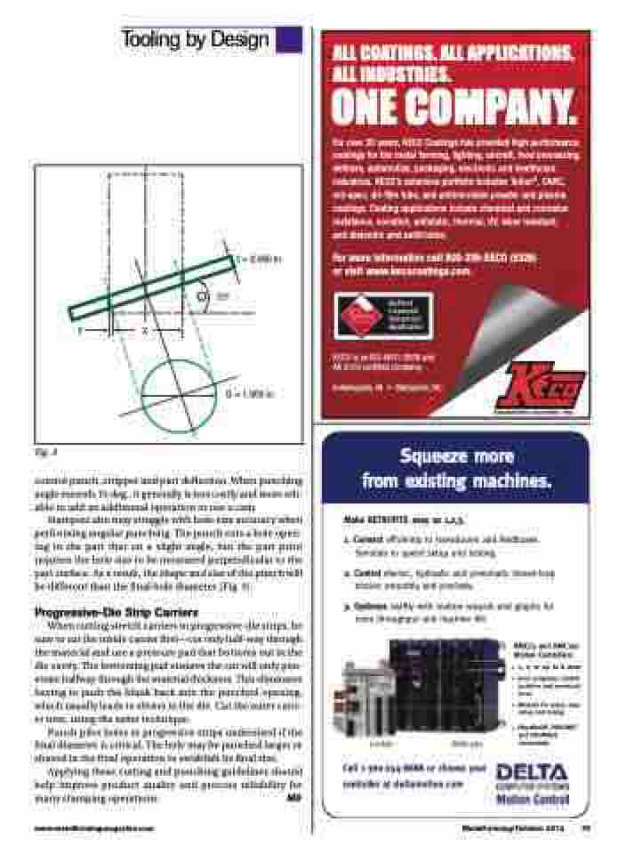

 Fig. 3
control punch, stripper and part deflection. When punching angle exceeds 15 deg., it generally is less costly and more reli- able to add an additional operation or use a cam.
Stampers also may struggle with hole-size accuracy when performing angular punching. The punch cuts a hole open- ing in the part that on a slight angle, but the part print requires the hole size to be measured perpendicular to the part surface. As a result, the shape and size of the punch will be different than the final hole diameter (Fig. 3).
