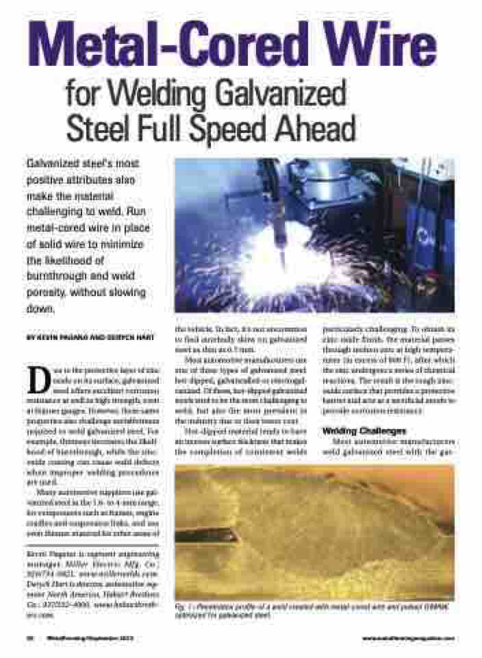

Galvanized steel’s most positive attributes also make the material challenging to weld. Run metal-cored wire in place of solid wire to minimize the likelihood of burnthrough and weld porosity, without slowing down.

Due to the protective layer of zinc oxide on its surface, galvanized steel offers excellent corrosion resistance as well as high strength, even at thinner gauges. However, these same properties also challenge metalformers required to weld galvanized steel. For example, thinness increases the likeli- hood of burnthrough, while the zinc- oxide coating can cause weld defects when improper welding procedures are used.

Fig. 1—Penetration profile of a weld created with metal-cored wire and pulsed GMAW, optimized for galvanized steel.
