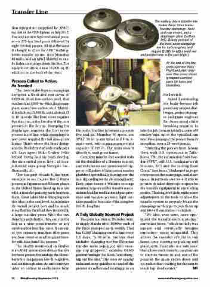

The press line runs at 16 strokes/min. to supply Mando with 10,000 of each of the three stamped parts weekly. That has GLMS changing out the line every 1.5 days, “a 90-min. process that includes changing out the Monobar transfer racks (equipped with vacu- um-cup grippers),” explains GLMS general manager Joe Sikes, “and chang- ing out the dies.” Die store on nearby racks and move quickly onto and off the presses via rollers and locating pins on
The walking-beam transfer line makes these three brake- booster stampings—front
and rear covers, and a diaphragm plate (bottom left). Twenty percent of
the front-cover stampings are for turbo engines, and
require GLMS to add a weld nut and welded tube to the part (right).
At the end of the line, press operator Kristi Pruitt and plant engi- neer Ben Jones visual- ly inspect stamped parts for burrs and blemishes.
the bolsters.
Asked if automating
the brake-booster job posed any unique chal- lenges, project manag- er and plant engineer Ben Jones noted a little tweaking required to
take the job from an initial run rate of 8 strokes/min. up to the specified run rate. Jones managed the project from its inception, over a 20-week period.
“Ordering the presses from Taiwan (Seyi, with U.S. operations in Tulla- homa, TN), the automation from Swe- den (AP&T, with U.S. headquarters in Monroe, NC) and the tooling from China,” says Jones, “challenged us to get everyone on the same page, and share specs. In particular, we weren’t able to provide detailed drawings or specs for the transfer equipment to our tooling source. That required us to make some adjustments to the tools to allow the transfer system to properly locate the stampings as they go to pick them up and move them station to station.
“We also, over time, have opti- mized the transfer-motion profile,” continues Jones, “which initially was square and eventually became smoother—more sinusoidal. This allows the transfer system to run faster, only slowing to pick up and place parts. There also is a ‘safe zone’ that allows each transfer mechanism to start its moves in and out of the press as the press cycles down and up, rather than waiting for the ram to reach top-dead center.” MF
