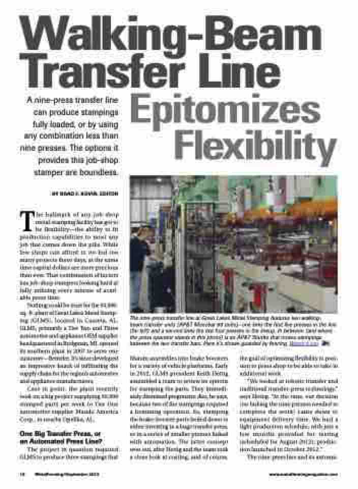

The nine-press transfer line at Great Lakes Metal Stamping features two walking-
beam transfer units (AP&T Monobar 80 units)—one links the first five presses in the line (far left) and a second links the last four presses in the lineup. In between (and where the press operator stands in this photo) is an AP&T Shuttle that moves stampings between the two transfer bars. Here it’s shown guarded by fencing. Watch it run.
