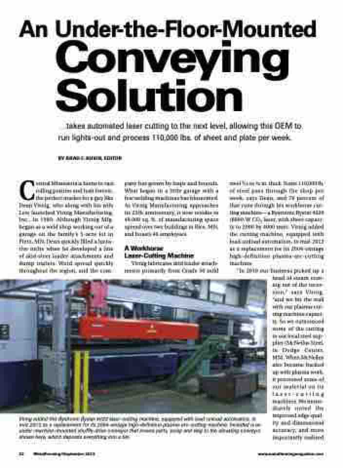

 Virnig added this Bystronic Bystar 4020 laser-cutting machine, equipped with load-unload automation, in mid-2012 as a replacement for its 2004-vintage high-definition plasma-arc-cutting machine. Included is an under-machine-mounted shuffle-drive conveyor that moves parts, scrap and slag to the elevating conveyor shown here, which deposits everything into a bin.
