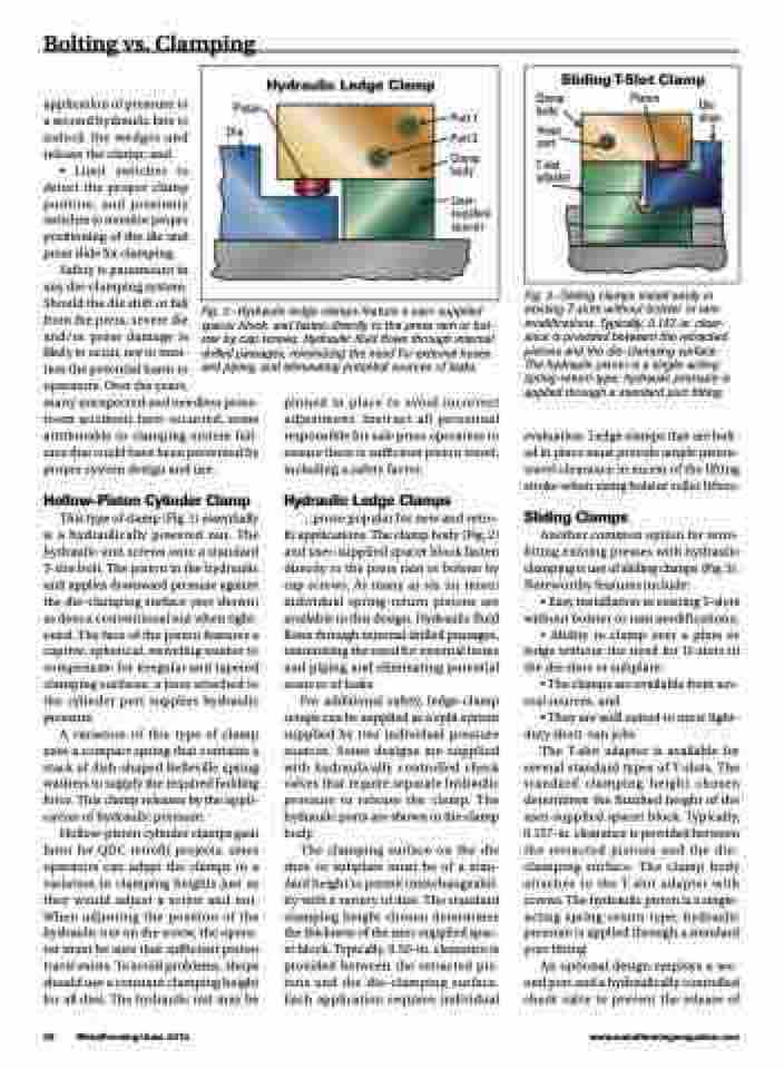

 Bolting vs. Clamping
  Hydraulic Ledge Clamp
Piston Die
Port 1
Port 2
Clamp body
User- supplied spacer
                   Clamp body
Hose port
T-slot adpator
Piston
Die shoe
SlidingT-Slot Clamp

Fig. 3—Sliding clamps install easily in existing T-slots without bolster or ram modifications. Typically, 0.157-in. clear- ance is provided between the retracted pistons and the die-clamping surface. The hydraulic piston is a single-acting spring-return type; hydraulic pressure is applied through a standard port fitting.

Fig. 2—Hydraulic ledge clamps feature a user-supplied spacer block, and fasten directly to the press ram or bol- ster by cap screws. Hydraulic fluid flows through internal drilled passages, minimizing the need for external hoses and piping, and eliminating potential sources of leaks.

...prove popular for new and retro- fit applications. The clamp body (Fig. 2) and user-supplied spacer block fasten directly to the press ram or bolster by cap screws. As many as six (or more) individual spring-return pistons are available in this design. Hydraulic fluid flows through internal drilled passages, minimizing the need for external hoses and piping and eliminating potential sources of leaks.
For additional safety, ledge-clamp setups can be supplied as a split system supplied by two individual pressure sources. Some designs are supplied with hydraulically controlled check valves that require separate hydraulic pressure to release the clamp. The hydraulic ports are shown in the clamp body.
The clamping surface on the die shoe or subplate must be of a stan- dard height to permit interchangeabil- ity with a variety of dies. The standard clamping height chosen determines the thickness of the user-supplied spac- er block. Typically, 0.50-in. clearance is provided between the retracted pis- tons and the die-clamping surface. Each application requires individual
