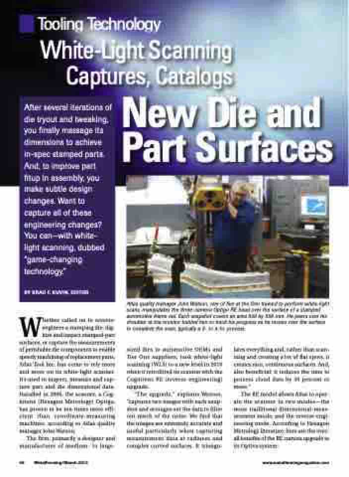

Atlas quality manager John Watson, one of five at the firm trained to perform white-light scans, manipulates the three-camera Optigo RE head over the surface of a stamped automotive frame rail. Each snapshot covers an area 500 by 500 mm. He peers over his shoulder at the monitor behind him to track his progress as he moves over the surface to complete the scan, typically a 3- to 4-hr. process.
