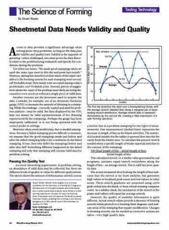

...is a more interesting requirement. In problem solving, an abundance of valid data may be collected, but there are different levels of quality or value for different applications. The sketch shows the amount of deformation (stretch) across

The first die stretches the steel over a hemispherical dome, with the average stretch (dashed line) doing a marginal job of repre- senting stretch distribution. Average stretch fails to represent deformation by the second die, creating a false impression of a safe forming operation.
a section line in a problem stamping for two types of meas- urements. One measurement (dashed lines) represents the increase in length of line as the blank stretches. The materi- al is locked outside the die radius to prevent flow into the die cavity from the binder area. To calculate the percent stretch needed when a specific length of binder material stretches to the contour of the stamping:
100 (final length of line – initial length of line) initial length of line
This calculated stretch, or a similar value generated by cad programs, assumes equal stretch everywhere along the length of line—an average stretch. This is valid but poor-qual- ity data.
The actual measured stretch along the length of line indi- cates that the stretch is far from uniform, but generates high values in localized peak zones and low values in other zones. These stretch gradients are measured using circle grids etched into the blank, or from virtual-forming computer codes. As a validity check, the summation of the stretch in the peaks and valleys will equal the average stretch.
However, the quality of available information is quite different. Actual stretch values provide a measure of forming severity when plotted on a forming-limit diagram, and indi- cate areas of the stamping that require modification. Changes in forming severity can be tracked as corrective actions are taken—very-high-quality data.
