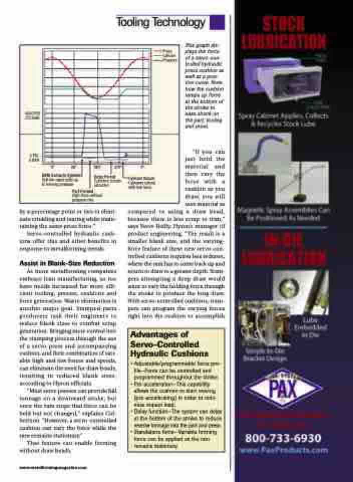

This graph dis- plays the force of a servo-con- trolled hydraulic press cushion as well as a posi- tion curve. Note how the cushion ramps up force at the bottom of the stroke to ease shock on the part, tooling and press.
“If you can just hold the material and then vary the force with a cushion as you draw, you will save material as
compared to using a draw bead, because there is less scrap to trim,” says Steve Reilly, Hyson’s manager of product engineering. “The result is a smaller blank size, and the varying- force feature of these new servo-con- trolled cushions requires less redraws, where the ram has to come back up and return to draw to a greater depth. Stam- pers attempting a deep draw would want to vary the holding force through the stroke to produce the long draw. With servo-controlled cushions, stam- pers can program the varying forces right into the cushion to accomplish

  Advantages of Servo-Controlled Hydraulic Cushions
• Adjustable/programmable force pro- file—Force can be controlled and programmed throughout the stroke.
• Pre-acceleration—This capability allows the cushion to start moving (pre-accelerating) in order to mini- mize impact load.
• Delay function—The system can delay at the bottom of the stroke to reduce reverse tonnage into the part and press.
• Standalone force—Variable forming force can be applied as the ram remains stationary.
