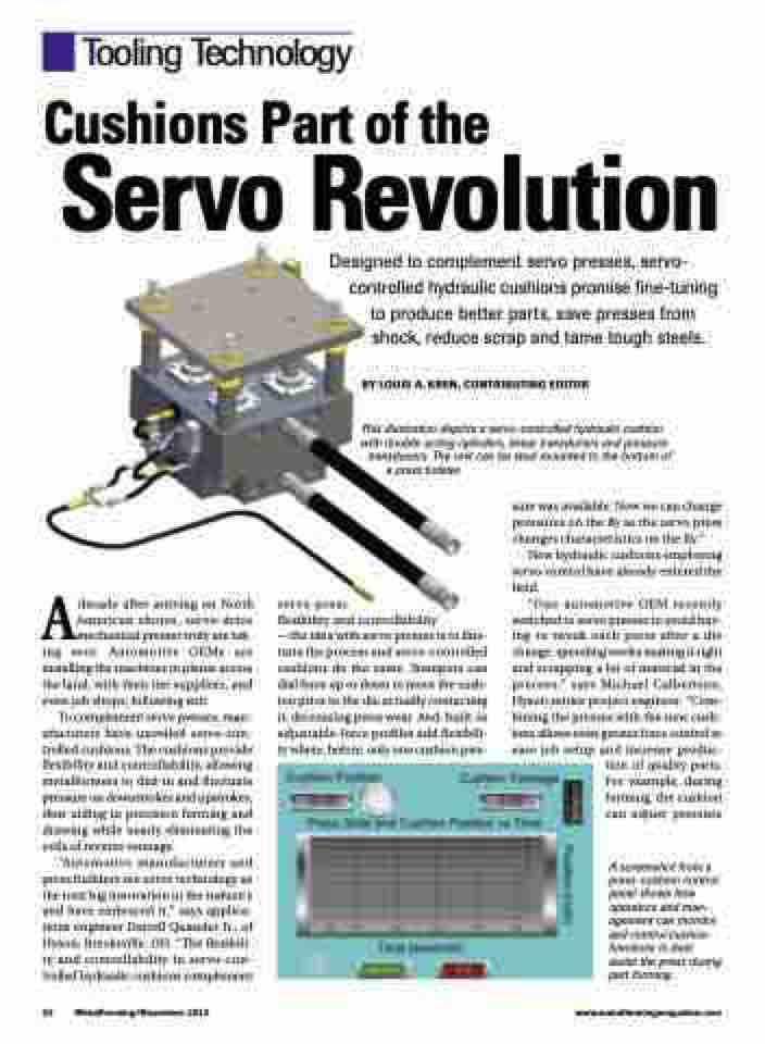

A screenshot from a press-cushion control panel shows how operators and man- agement can monitor and control cushion functions to best assist the press during part forming.

This illustration depicts a servo-controlled hydraulic cushion with double-acting cylinders, linear transducers and pressure
transducers. The unit can be stud-mounted to the bottom of a press bolster.
