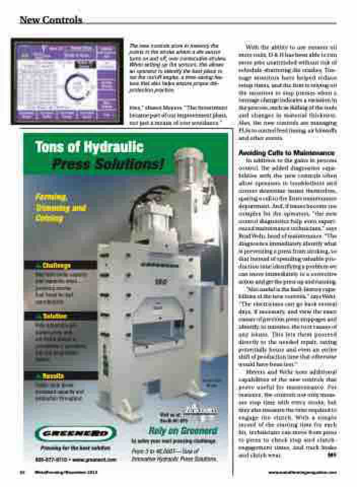

The new controls store in memory the points in the stroke where a die sensor turns on and off, over consecutive strokes. When setting up the sensors, this allows an operator to identify the best place to set the on/off angles, a time-saving fea- ture that also helps ensure proper die- protection practice.
