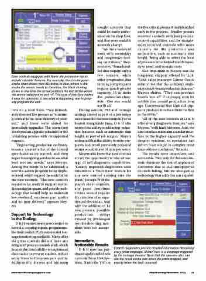

 Even controls equipped with fewer die-protection inputs include valuable features. For example, the circular press- stroke chart shown here illustrates, in blue, where in the stroke the sensor needs to transition; the black shading shows in real time the actual points in the last stroke where the sensor switched on and off. This type of interface makes it easy for operators to see what is happening, and to prop- erly program the unit.

Control diagnostics provide detailed information describing every press stoppage. Shown here is a stoppage triggered by the tonnage monitor. Note that the operator also can see the press stroke rate when the press stopped, and exactly when the fault occurred.
