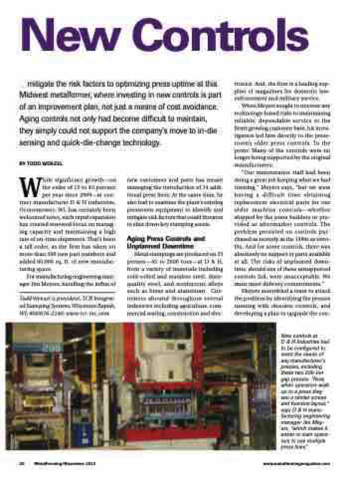

...mitigate the risk factors to optimizing press uptime at this Midwest metalformer, where investing in new controls is part of an improvement plan, not just a means of cost avoidance. Aging controls not only had become difficult to maintain, they simply could not support the company’s move to in-die sensing and quick-die-change technology.
tronics. And, the firm is a leading sup- plier of magazines for domestic law- enforcement and military service.
When Meyers sought to uncover any technology-based risks to maintaining reliable, dependable service to the firm’s growing customer base, his inves- tigation led him directly to the press- room’s older press controls. To the point: Many of the controls were no longer being supported by the original manufacturers.
“Our maintenance staff had been doing a great job keeping what we had running,” Meyers says, “but we were having a difficult time obtaining replacement electrical parts for our older machine controls—whether shipped by the press builders or pro- vided as aftermarket controls. The problem persisted on controls pur- chased as recently as the 1990s as retro- fits. And for some controls, there was absolutely no support or parts available at all. The risks of unplanned down- time, should one of these unsupported controls fail, were unacceptable. We must meet delivery commitments.”
Meyers assembled a team to attack the problem by identifying the presses running with obsolete controls, and developing a plan to upgrade the con-
New controls at
D & H Industries had to be configured to meet the needs of any manufacturer’s presses, including these two 200-ton gap presses. “Now, when operators walk up to a press they see a similar screen and function layout,” says D & H manu- facturing engineering manager Jim Mey- ers, “which makes it easier to train opera- tors to use multiple press lines.”
