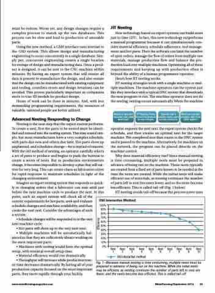

Why does material efficiency rise? Since manual nesting is time consuming, multiple nests must be prepared in advance of being run on the machine. These nests typically are created from a fixed set of parts known to be needed at the time the nests are created. While the initial nests will make efficient use of materials, as nesting continues the number of parts left to nest becomes fewer, and so the nests become less efficient. This is called tail-off (Fig. 1 below).
JIT nesting avoids tail-off because the process never runs
 Old Interactive Method
100% 90% 80% 70% 60% 50% 40% 30% 20% 10% 0%
Nest Nest
1 2 3 4 5 6 7 8 9 10
         Nest Nest
Nest Nest Nest Nest Nest Nest
Old interactive method

Fig. 1—Because manual nesting is time consuming, multiple nests must be prepared in advance of being run on the machine. While the initial nests may be efficient, as nesting continues the number of parts left to nest are fewer, and the nests become less efficient. This is called tail-off.
Efficiency
