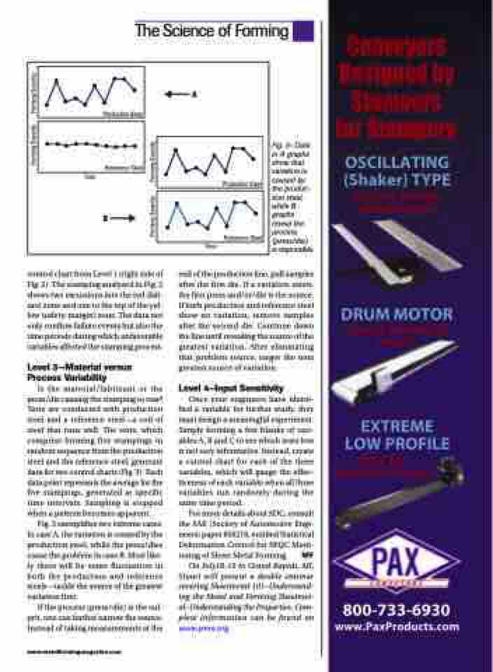

Level 3—Material versus Process Variability
Is the material/lubricant or the press/die causing the stamping to tear? Tests are conducted with production steel and a reference steel—a coil of steel that runs well. The tests, which comprise forming five stampings in random sequence from the production steel and the reference steel, generate data for two control charts (Fig. 3). Each data point represents the average for the five stampings, generated at specific time intervals. Sampling is stopped when a pattern becomes apparent.
Fig. 3 exemplifies two extreme cases. In case A, the variation is created by the production steel, while the press/dies cause the problem in case B. Most like- ly there will be some fluctuation in both the production and reference steels—tackle the source of the greatest variation first.
If the process (press/die) is the cul- prit, one can further narrow the source. Instead of taking measurements at the
Fig. 3—Data in A graphs show that variation is caused by the produc- tion steel, while B graphs reveal the process (press/die) is responsible.
end of the production line, pull samples after the first die. If a variation exists, the first press and/or/die is the source. If both production and reference steel show no variation, remove samples after the second die. Continue down the line until revealing the source of the greatest variation. After eliminating that problem source, target the next greatest source of variation.
