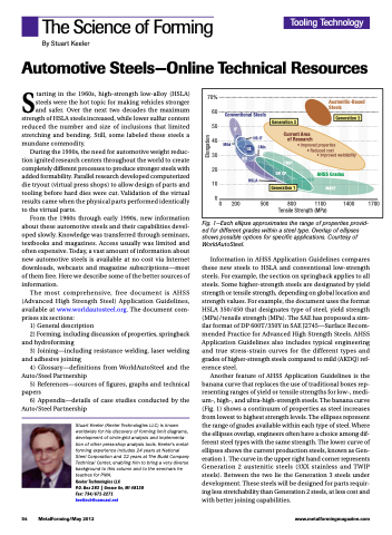

Fig. 1—Each ellipse approximates the range of properties provid- ed for different grades within a steel type. Overlap of ellipses shows possible options for specific applications. Courtesy of WorldAutoSteel.
Information in AHSS Application Guidelines compares these new steels to HSLA and conventional low-strength steels. For example, the section on springback applies to all steels. Some higher-strength steels are designated by yield strength or tensile strength, depending on global location and strength values. For example, the document uses the format HSLA 350/450 that designates type of steel, yield strength (MPa)/tensile strength (MPa). The SAE has proposed a sim- ilar format of DP 600T/350Y in SAE J2745—Surface Recom- mended Practice for Advanced High Strength Steels. AHSS Application Guidelines also includes typical engineering and true stress-strain curves for the different types and grades of higher-strength steels compared to mild (AKDQ) ref- erence steel.
Another feature of AHSS Application Guidelines is the banana curve that replaces the use of traditional boxes rep- resenting ranges of yield or tensile strengths for low-, medi- um-, high-, and ultra-high-strength steels. The banana curve (Fig. 1) shows a continuum of properties as steel increases from lowest to highest strength levels. The ellipses represent the range of grades available within each type of steel. Where the ellipses overlap, engineers often have a choice among dif- ferent steel types with the same strength. The lower curve of ellipses shows the current production steels, known as Gen- eration 1. The curve in the upper right hand corner represents Generation 2 austenitic steels (3XX stainless and TWIP steels). Between the two lie the Generation 3 steels under development. These steels will be designed for parts requir- ing less stretchability than Generation 2 steels, at less cost and with better joining capabilities.
