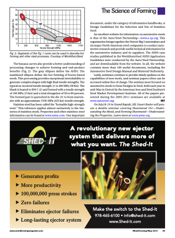

  Fig. 2—Segments of the Fig. 1 curve can be used to describe hot forming and other steel processes. Courtesy of WorldAutoSteel.
The banana curves also provide a better understanding of processing changes to achieve forming and end-product benefits (Fig. 2). The gray ellipses define the AHSS. The numbered ellipses define the hot forming of boron-based steels. This processing provides exceptional stretchability to generate complex shapes with high final tensile strengths. The typical as-received tensile strength (1) is 400 MPa (58 Ksi). The blank is heated to 850 C (2) and formed with a tensile strength of 100 MPa (15 ksi) and a total elongation of 50 to 60 percent. The formed part is quenched in the die (3) to form marten- site with an approximate 1550-MPa (225 ksi) tensile strength.
