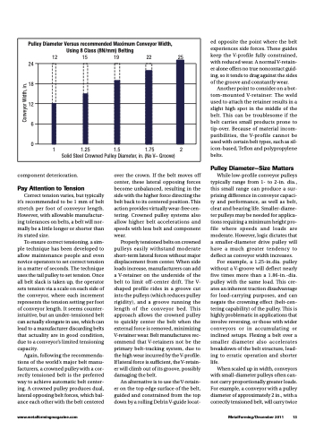

  Pulley Diameter Versus recommended Maximum Conveyor Width, Using 8 Class (8N/mm) Belting
 24
18
12
6
12 15 19 22 25
             1 1.25 1.5 1.75 2 Solid Steel Crowned Pulley Diameter, in. (No V– Groove)

While low-profile conveyor pulleys typically range from 1- to 2-in. dia., this small range can produce a sur- prising difference in conveyor capaci- ty and performance, as well as belt, cleat and bearing life. Smaller-diame- ter pulleys may be needed for applica- tions requiring a minimum height pro- file where speeds and loads are moderate. However, logic dictates that a smaller-diameter drive pulley will have a much greater tendency to deflect as conveyor width increases.
For example, a 1.25-in.dia. pulley without a V-groove will deflect nearly five times more than a 1.86-in.-dia. pulley with the same load. This cre- ates an inherent traction disadvantage for load-carrying purposes, and can negate the crowning effect (belt-cen- tering capability) of the pulley. This is highly problematic in applications that involve reversing, or those with wider conveyors or in accumulating or inclined setups. Flexing a belt over a smaller diameter also accelerates breakdown of the belt structure, lead- ing to erratic operation and shorter life.
When scaled up in width, conveyors with small-diameter pulleys often can- not carry proportionally greater loads. For example, a conveyor with a pulley diameter of approximately 2 in., with a correctly tensioned belt, will carry twice
