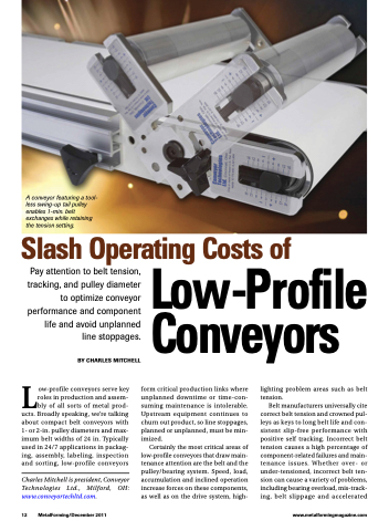

 A conveyor featuring a tool- less swing-up tail pulley enables 1-min. belt exchanges while retaining the tension setting.
