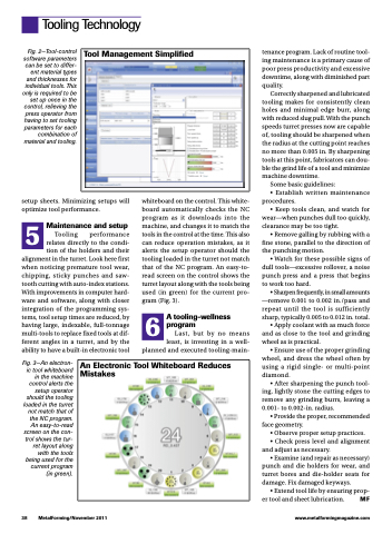

Fig. 3—An electron- ic tool whiteboard in the machine control alerts the setup operator should the tooling loaded in the turret not match that of the NC program. An easy-to-read screen on the con- trol shows the tur- ret layout along with the tools being used for the current program (in green).
whiteboard on the control. This white- board automatically checks the NC program as it downloads into the machine, and changes it to match the tools in the control at the time. This also can reduce operation mistakes, as it alerts the setup operator should the tooling loaded in the turret not match that of the NC program. An easy-to- read screen on the control shows the turret layout along with the tools being used (in green) for the current pro- gram (Fig. 3).
