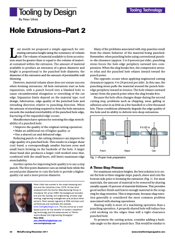

       R 0.020 in.
         Punch Shave
Coin
Fig. 1—Proper hole preparation
A Three-Step Process
For maximum extrusion heights, the best solution is to cre- ate the hole in three singular steps: punch, shave and coin the bottom side prior to forming the extrusion (Fig. 1). For most materials, the amount of material to be removed by shaving usually equals 10 percent of material thickness. This provides good surface finish and leaves enough material in the scrap ring for slug retention. This is important, because slug reten- tion generally is considered the most common problem associated with shaving operations.
Shaving really is more of a machining operation than a punching operation. A properly shaved hole will induce less cold working on the edges than will a tight-clearance punched hole.
