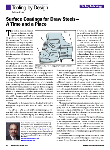

The corners in box-shaped geometries form similarly to cup drawing. If the four straight walls of the box are removed so that the corners join together, they form a cylindrical cup. These corners are compressive on the workpiece material moving toward the die radius, and tensile on the material drawn over the radius (see the fig- ure). As a result, thickening occurs in the vertical wall (A) and the
flange remaining on the draw pad (B) near the draw corners. This thickening phenomenon sometimes is overlooked during CNC programming and machining. Worse yet, the

   A
B
Stretch bend
Bend and
Box CL
Stretch bend
Bend and straighten
        straighten
     Compression
    The corner of a box or irregular draw corner forms like a cup.
