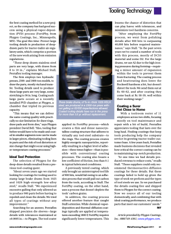

  These brake drums, of 3⁄8-in.-thick 1025 HSLA steel, are produced in a 2300-ton press with- out galling or ID/OD imperfections allowed. Coated tooling details have run in the press for more than 3.5 yr. without replacement.
