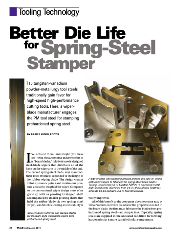

Trico Products rollforms and stamps blades for its beam-style windshield wipers from prehardened spring steel.
A pair of small-bed stamping presses pierces and cuts-to-length rollformed shapes to fabricate the spring-steel beam blades. Tooling (shown here) is of Erasteel ASP 2015 powdered-metal high-speed steel, machined from 2.5-in.-thick blocks, heattreat- ed to Rc 63-64 and wire-cut to final dimensions.
