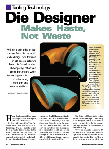

Dilast developed transfer tools
to stamp this stainless-steel exhaust assem- bly, making
use of the new Target Driven Deformation fea- ture within Visi die-design soft- ware. TDD allowed the firm to quickly over- come formability issues so that within a few hours it could submit the new
geometry back to the customer for air-flow
testing. Designing the assembly, which required a maximum weld gap of 0.5 mm, Dilast input part geometry from CMM results out of the tooling and reverse-engineered new geometry using the TDD feature to alter form steels.
