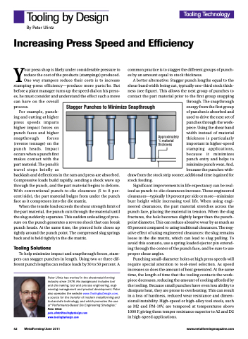

To help minimize impact and snapthrough forces, stam- pers can stagger punches in length. Using two or three dif- ferent punch lengths can reduce loads by 30 to 50 percent. A

common practice is to stagger the different groups of punch- es by an amount equal to stock thickness.
A better alternative: Stagger punch lengths equal to the shear band width being cut, typically one-third stock thick- ness (see figure). This allows the next group of punches to contact the part material prior to the first group snapping
through. The snapthrough energy from the first group of punches is absorbed and used to drive the next set of punches through the work- piece. Using the shear band width instead of material thickness is particularly important in higher-speed stamping applications, because it minimizes punch entry and helps to minimize punch wear. And, because the punches with-
draw from the stock strip sooner, additional time is gained for stock feeding.

 Stagger Punches to Minimize Snapthrough
          Approximately 1/3 material thickness
